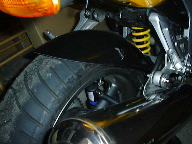

30/08/00 - REJETTING AUSSIE STYLE - Greg (greg@cockatoocomputing.com) send us this information...
The SV650 site is a great resource - only just recently discovered it. I noted that in the FAQ/how to, with rejetting carbies there seems to be a whole heap of information on shimming carby needles. This perplexes me somewhat as my SV needle has a clip with 5 slots. In standard form the clip was in the middle position on the needle.
After installing a Yoshi pipe, I just had to drop the clip down one slot, no need to add shims or whatever. This is what I have done for the past 30 years in adjusting low-mid range jetting. My only thought was that perhaps only the Australian (SV650S E-24) model has a needle with an adjustable clip. Can anyone confirm this? Ummm...I can't, can anyone else??
The SV service manual even shows the needle with a clip & alternative positions. I have attached a scan of the page from the manual which shows the SV carby - this may of help for the FAQ pages.
The SV is a great bike - however the front forks are nothing to write  about. My next project is re-valve the forks.
btw: the yoshi pipe + adjust the needle transform the SV - it just goes - awful hard to keep the front wheel on the deck!
Image 1

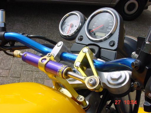

30/08/00 - SPRINGS, SHOCKS & STEERING DAMPERS ON OFFER - Contact information below...
We have some good springs , shocks and steering damper kits for the SV650

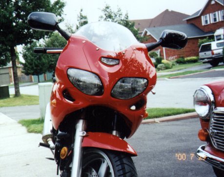

25/08/00 - DUEL HEADLIGHTS HELP REQUIRED - Can you help Jay (palmer_jay@hotmail.com)?
I am american sv rider. Just want too let you know I love your site and my bike. My question is about a picture that you have in catalog 6. its of a black sv with duel headlights. I would like to do this to my sv to make it look different than most. If you could would you Email me any info that you might have.
oh how much is the renegade duel exhaust in american money. see http://www.sv650.org/sv_renegade.htm, go to the Renegade site http://www.renegade-exhausts.com/ and look up the price for the kit you want, then use the currency calculator http://www.x-rates.com/calculator.html to translate the price.

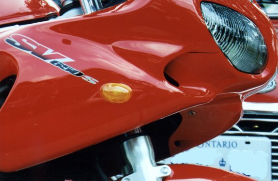

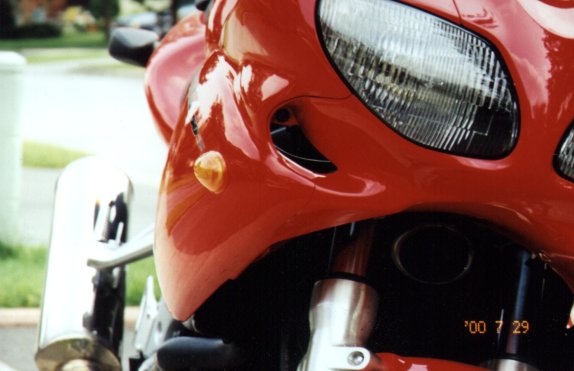

22/08/00 - MODIFIED TURN SIGNALS - As supplied by Austin (cosmo@austinoffice.com)...
I have a '99 SV650S, bought new last April, from Ontario, Canada. I've been following the site for a while, great job.
Here are some pics of my new front signal lights. They are only fastened with tie wraps, but they seem to be okay and they just barely cover up the stock holes.
Image 1      Image 2      Image 3      Image 3
Just a question...how the hell do people see you turning with signals that small?? I don't think I'd last five minutes on UK roads with them, it's bad enough as it is with full sized BS-marked and approved signals...

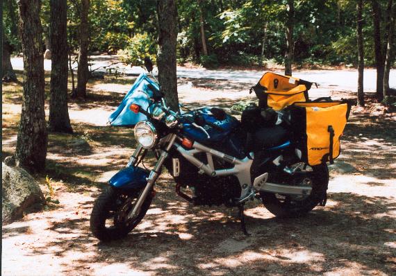

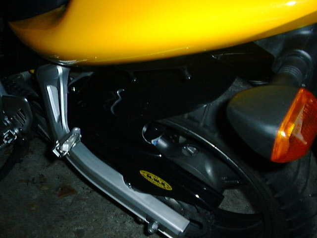

16/08/00 - SV WITH YELLOW AEROSTICH DRYBAGS - Ed (EIM1138@aol.com) digs his bags...
Made by "Ortlieb." Good bags, hose 'em off if they get dirty. I got more compliments with these bags on my bike in like 3 days than I had received in the entire 4 months previous. (The bags are open in pics, the roll closed but, you can see how much room you have to cram stuff in there. I'll try to get ya some pics with them closed.)
Boy, I sound like a frigg'n sales rep huh? yeah.. Well I ain't. I just dig my bags. You can get 'em in black as well.
www.aerostich.com     see actual images above

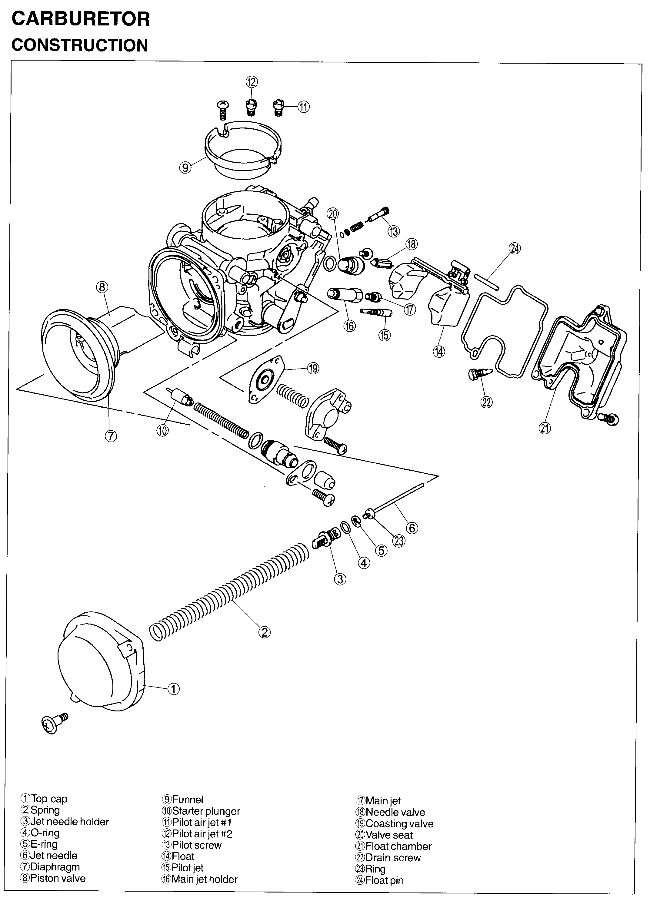

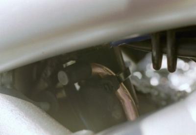

11/08/00 - FAULT FOUND ON CARBS - Richard (hot_ras@hotmail.com) describes his problem....
Great site for a great bike! Fault found.
Last week I decided to check my bike over (SV650SY) and whilst checking the air filter I noticed that the air box was very loose. On further investigation I found that is was in fact the carbs that were loose. I noticed that the clip that holds the carbs to the inlet manifold had the screw missing. Luckily it was still resting on the V of the engine block.
After about 10 mins (very poor access) I managed to refit the screw and tighten it up. The rear carb clip was very loose as well. I don't know how this would have effected the performance / reliability, but it surprised me that it could happen after only 4000 miles.
Has anyone else found a similar fault?

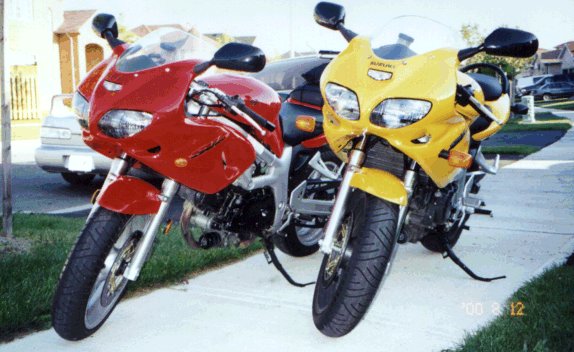

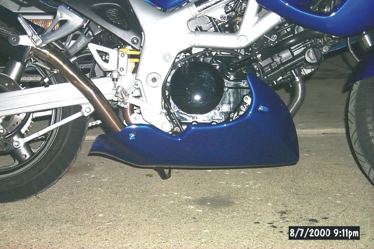

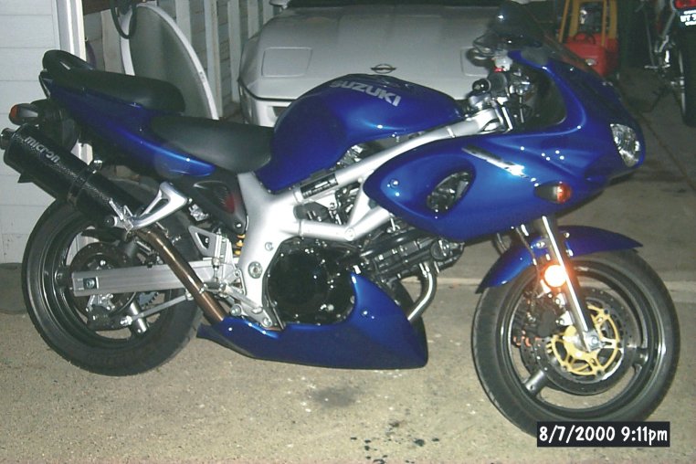

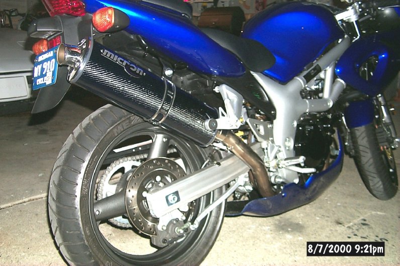

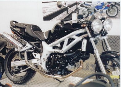

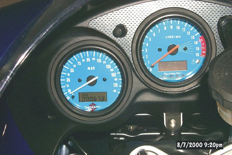

09/08/00 - SV IMAGES - Chris (cagrusa@email.msn.com) sends these...
Here are some pics of my SV here in Michigan, U.S.A. I bought it about 2 months ago in Canada.
Mods are: Micron high level full race exhaust Carbon-Kevlar canister
Dynojet jet kit (stage one)
Lower spoiler (bellypan) from Eurobikes
Custom gages in MPH
Please post these pics on your site
Image 1      Image 2      Image 3      Image 4

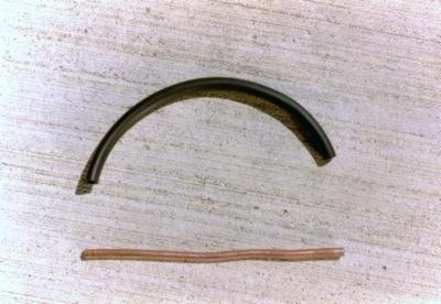

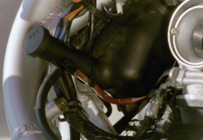

09/08/00 - TUNING MODIFICATION - Some useful info here from Bruce (bbrodnax@uci.edu) for anyone who wants to try it...
Anyone who's owned their SV longer than 6mos & who is willing to do minor maintenance themselves will likely want to balance their carbs. Suzuki makes this a maintenance nightmare, by virtue of where the vacuum lead for the front carb lies.
I made a modification that entailed buying about $2 worth of parts that will make future carb balancing a 15-minute operation instead of the horror Suzuki envisioned where you have to remove the airbox, drop the radiator & fan, etc. just to get at the vacuum spigot. Those parts are some copper tubing (hardware store, 1/4", so the existing little plastic condom from the vacuum spigot will fit) and some rubber vacuum line to fit (car parts store; cost me $.85 for a foot, which was about 2x as much as required.)
Attach vacuum line to spigot, zip tie or spring clamp in place. Make a nice bend in the copper tube to follow the line of the radiator overflow & stuff it into the vac. line. Zip tie or spring clamp in place. Try fitting the airbox back on, discover that you need to make a 90deg bend to bring the end out between frame rails on side of bike; zip tie
copper tube to overflow tank to keep from rattling about. Put plastic condom on end of copper tube.
If you do this job as part of the more involved tasks of shimming the carb needles or drilling out the blanks over the idle air adjusters, you're looking at adding maybe 1/2 hour to the total job time (if  you're mechanically inept like myself. Less for normal people...)
Having this in place will make balancing the carbs a simple matter, which means it gets done more often, which means you get better mileage and ridability.

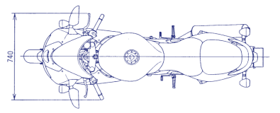

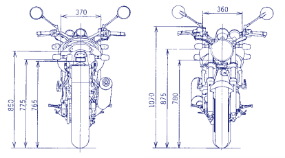

04/08/00 -  TECHNICAL DRAWING IMAGES - Thanks very much Mirko (mirko.valagussi@sdrc.com)....

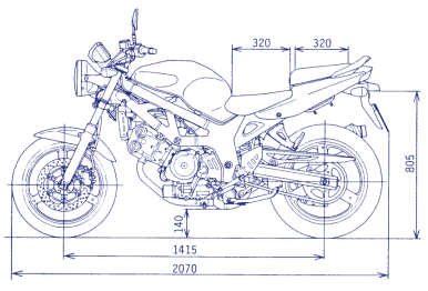

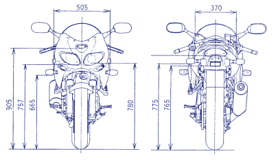

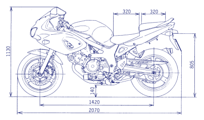

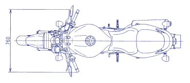

I would like to donate some interesting drawings ....Enjoy
Image 1      Image 2      Image 3      Image 4      Image 5      Image 6

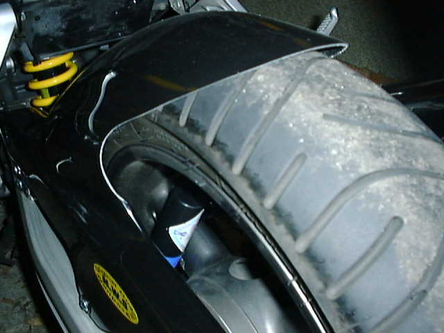

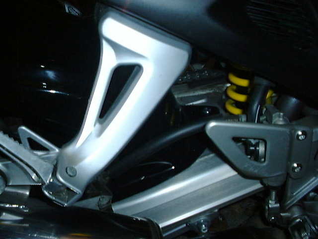

04/08/00 -  NWS HUGGER IMAGES - Thanks this time to Kevin (kevin.spud@talk21.com)....
Here are a few pictures of the NWS hugger in GPS black.
P.S no point doing a stages set of pictures as these should be self explanatory and it's a doddle anyway.........
04/08/00 -  RENEGADE LOW-LEVEL TWIN SYSTEM IMAGES - These sent from pleased customer Hammy (jon@mikweb.net)...
After reading so many encouraging comments from others, especially on Kevin's SV650 site I decided to take the plunge and booked my baby in at Renegade.
I went for the twin, low-level, oval, titanium system. This seemed the best option for someone who often carries soft panniers and I didn't want the system to look too obviously 'aftermarket'.
I spent a very enjoyable day with Jorge and the rest of the Renegade crew. They truly love their work and know that they have an unbeatable product. I chatted to staff, other customers, helped Jorge with his PC and even took customer phone calls when Jorge felt they needed to hear about the product from 'the horses mouth'!
I finally left at around 5pm, the proud owner of the very first twin low-level system for a Suzuki SV650SY. I can only echo what everyone else has been saying for ages. Forget the rest, get a Renegade system and do it NOW - you won't regret it!!
Other modifications on the bike include:-
From MPS (www.thefastone.co.uk)
Airflow Screen
Front Mudguard Extenda
Carbon Look Tank Protector
Mini Carbon Look Smoked Rear Indicators
Flush Aero Smoked Front Indicators
From M&P (www.mandp.com)
Undertray (a complete ba***rd to fit!)
From Pyramid Plastics (www.pyramid-plastics.co.uk)
Carbon Look Hugger
Plus a Scottoiler and Sola Alarm under the front seat.

We just got back from our 2nd trip to Europe with our 2000 650SVS. Again, the bike proved to be a very worthwhile tourer, we put about 2800 miles on the clock in 14 days. (France, Switzerland- snow on the passes- pretty interesting on a motorcycle- Austria and Germany). The only problem experienced was an electrical failure on the autobahn in Germany.
While cruising at about 75-80 mph, the bike stopped dead. There was no spark to the engine at all, but the lights were fine. Pulling off to the side of the road we found the 10 amp ignition circuit blown. We put a spare 10 amp fuse in and it blew immediately. Having seen previous postings regarding the problem (I think it was John Tapley who told me about this originally) with the seat holdown screw chaffing the wire loom on the left hand side, we checked this (I had looked at it previous to the trip
also) and could not find anything apparent. After about a half and hour of looking, probing and scratching our head, we put another spare fuse in, 15 amp (last one) and it held.
We subsequently took it to a Suzuki dealer near Koblenz who checked everything over, cleaned all the contacts, etc. etc. and could also not find anything wrong. (This dealer was excellent- he took us right in, spent about an hour with the bike, cleaned it and charged us nothing). The problem had obviously 'fixed itself', or had at least gone away for a while.
It got us back to the UK with no more problems, but not being convinced that all was really well, I took another real close look at the wire bundle on the left hand side under the seat. I pulled the black tape away from the bundle where the wire passes against the tab that holds the seat hold down screw. (You have to cut the factory zip tie and pull the wire bundle down a bit away from the frame to do this). Upon closer inspection, I could see where one of the wires had a very small black mark where in had chaffed through and arced, shorting out against the metal tab for the seat screw.
I taped the bundle again with electrical tape, and then put a section of bicycle inner tube, cut to size and slit down the middle, around the bundle then taped it again to offer greater chafe protection. I then zip tied the wire bundle both forward and aft of the seat tab to the UPPER rail. This pulls the wire bundle completely away from the seat tab, as the wires  on my bike were resting against this tab. Even tho there appears to be no movement, there obviously is as mine chaffed through, just barely but
enough to put us on the side of the autobahn with cars whizzing past at 100+. I don't want to do that again....
I really think Suzuki should put a service note out about this or something, as I would think just about every SV out there is a candidate for this to happen.
