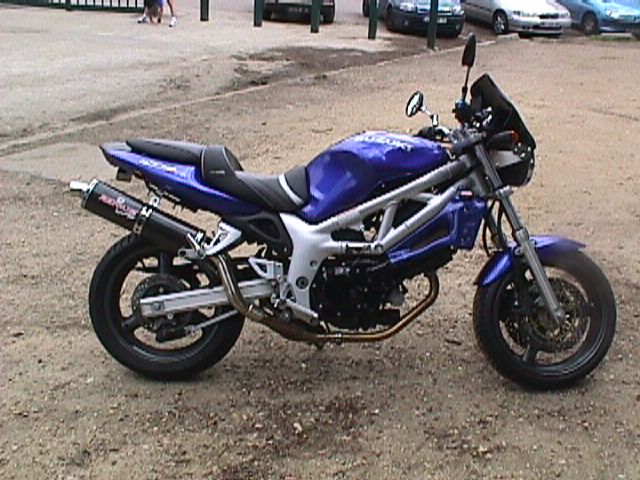

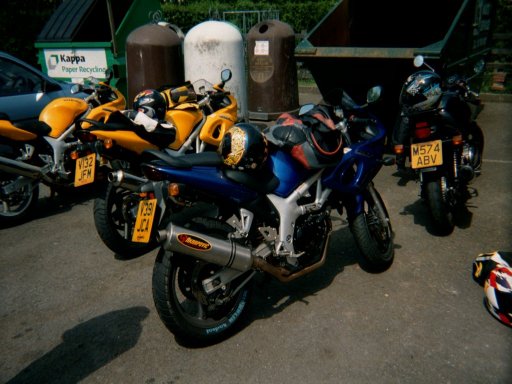

26/06/00 - REMUS PIPE IDENTIFIED & THE SV WINS - Thanks Peter (michael.johnston@hvr-csl.co.uk)...
In response to Des's question re. which pipes are on the SV in Atchoum's pictures, it looks suspiciously like a Remus can. I went around the Alexandra Palace show earlier this year looking at exhausts and Remus were just in the process of bringing out a load of pipes for the SV. Their range seems to be quite extensive, but I have no other information such as noise volume, power gains etc.
One other point of interest; the August edition of Superbike magazine reviews the naked SV against the Fazer, the faired Hornet, the naked Bandit and the Ducati Monster 600. Guess which one wins? Yup, the SV! The final choice was between the SV and the Fazer, and the SV won because it was fun! I'll second that ... nice one..

22/06/00 - QUERYING PHOTO BELOW - Des (des105@webhart.net) is asking about a pipe shown in a post below...
In re: to Atchoum (nain_atchoum@yahoo.fr) posting of 20/06/00, what pipes are in that pic?!   Atchoum...care to let us know?

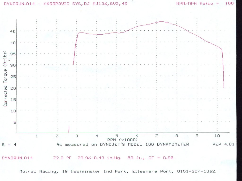

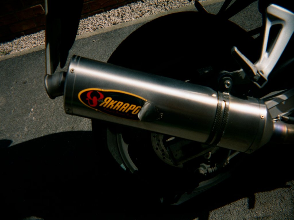

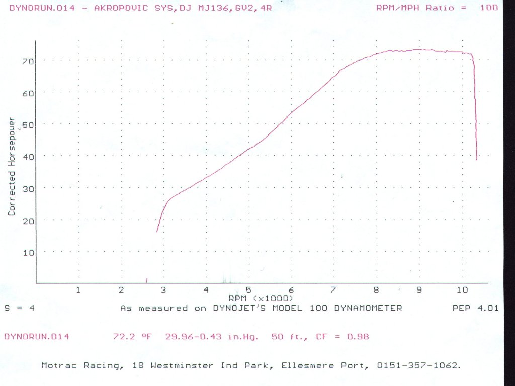

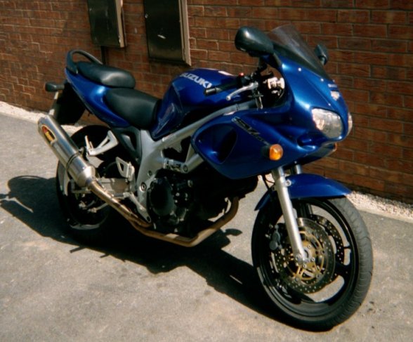

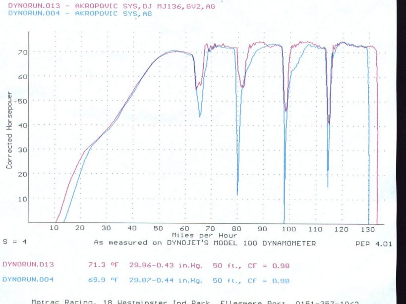

20/06/00 - AKRAPOVIC SYSTEM DYNO GRAPHS & IMAGES - Thanks for sending these in Martyn (martyn@thinktank.freeserve.co.uk)...
Here are a few pictures of my SVS, and a few graphs from when I got it dyno'd.
On the comparison graph, the comparison was between the Akrapovic titanium can/stainless pipes with and without re-jetting. Although you do not need to re-jet with this system, I would fully recommend it! Steve Hammond at Motrac Racing (www.motrac.demon.co.uk), has worked for both SBK and 500 GP teams, and I couldn't recommend him highly enough. Excellent service, and really knows what he is doing. It looks like quite a gain! It feels a hell of a lot better! And the sound! I will post some sound files as soon as is technically possible!
Image 1      Image 2     Image 3    Single Graph      Comparison Graph      Torque graph
PS...Martyn, I can't post your MCN images due to copyright laws but thanks for sending them, I missed all that article..

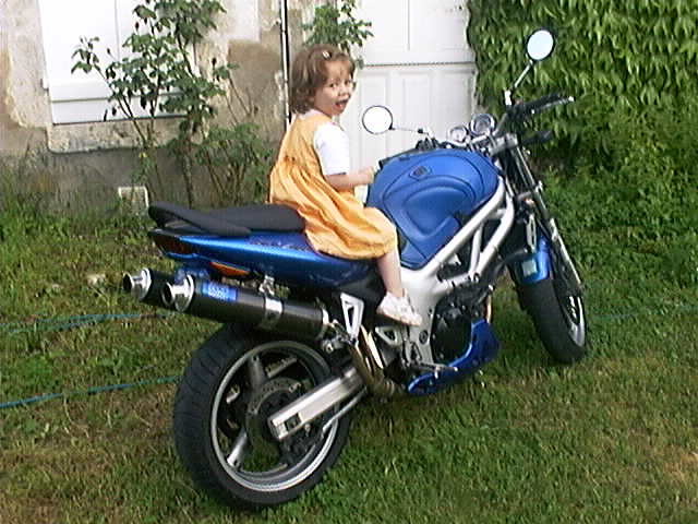

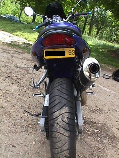

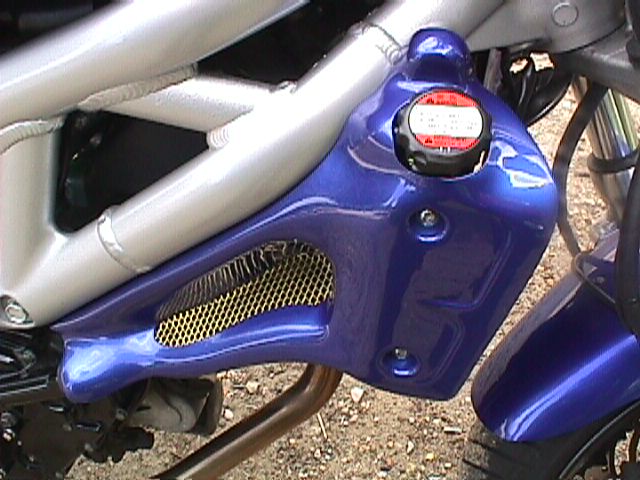

20/06/00 - RADIATOR COVER IMAGES - Atchoum (nain_atchoum@yahoo.fr) kindly sends this from France...
I buy this radiator cover in France, but i don't know, if you can to buy this by net.
But you can see the web site "Poly26.com" (French bodywork site with modified SV shown...also click on Suzuki and another image is shown) this is a polyestère store in france.

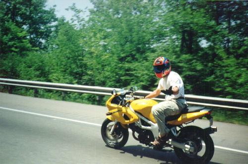

19/06/00 - GEL SEAT, FLY SCREEN, TANK BRA - I couldn't be arsed to sort out the screen info and post that in the fairings section so here's the whole email from I know not who (unk??) (jpbrdn@email.msn.com)... it's a bit rambling but what the heck for once...and it demonstrates why it's not a good idea to ride in shoes....
I purchased my 2000 model blue SV650 last March and can't say enough good things about it. I have a tendency to research things that capture my interest exhaustingly and I was more than confident that the SV was an outstanding bike. I even posted the first review of the bike on www.motorcycleworld.com (unfortunately a text editor glitch reduced my review to 2 sentences - they sent gobs of freebies to compensate me - very nice people) and I have since received five inquiries from new buyers asking advice. I have referred them all to your site and I can honestly say that the availability of such a volume of information and support from your website has turned a couple of potential Bandit and Katana buyers into  SV owners.
The only options I've added so far are the flyscreen, tank bra, and gel seat. The fly screen from Suzuki is a nice addition. I went from riding a 1982 Kawasaki 750 LTD (still have it - restored) to a 1995 Kawasaki Vulcan 750 and being cruiser the seating is such that the wind isn't as much of a factor as on my naked SV. With the fly screen (about $68 U.S. through a parts warehouse I found in the back of Cycle World) I can ride at 70mph and when I slowly raise my hand in front of me I don't feel real wind resistance until my hand is almost chin level. I'm 5'-7" so obviously that will vary but it does deflect a good bit of wind. It comes with attractive aluminum mounts and allen head bolts to replace the stock headlight mounting bolts.
The tank bra I consider a must ($28 U.S.). I saw a pic of one from another posting and it was dealer installed according to the author. He complained of the wrinkles in it. Mine fits quite tightly and looks great. You should remove the tank mounting bolts, slide the band above where the bolt holes are (the bolt heads get in the way if installed) then snug the bra back and bend the attached tabs under the rear tank edge (with the seat removed of course). The seams of the bra when installed correctly with line up with the contoured curves of the tank where your knees rest. Be sure to remove it and let it dry if it gets wet or your paint will start to fade underneath.
The gel seat I purchased was the carbon fiber covered seat (about $126 U.S.). I actually only notice a little difference. If I were to buy again I would get the plain gel seat and buy some black vinyl dye to make it match the black color of the stock seat. I think the carbon fiber cover takes away a little cushioning that the gel has to offer since it's a firmer weave. I also am starting to notice what looks like a delaminating in some spots over the carbon fiber.
I also purchased a Tour Master tail bag which is very convenient. The bungees are very narrowed though so I bought some self-adhesive felt and cut small squares that I wrapped around the bungees to protect the plastic tail section. Previously use without the felt left little marks from the bungees which have become a permanent part of my bikes "character".
After I pay off the SV I'm going to buy an exhaust, either Two Brothers or Renegade. I figure by then it will make it seem like I have a new bike again as far as feel and sound is concerned.
One last thing, I've come to appreciate my non-faired bike. I have yet to buy a pair of riding boots and wish I has already. A couple of times my boot laces have snagged on the pegs, never seriously causing a problem. Recently however when pulling into the back of my house my right lace got snagged on the rear-end from a '65 Mustang sitting there (gotta clear the clutter!). Needless to say I laid down my bike, first time ever, and wasn't going but 1mph if that. I couldn't hold up the bike with my right leg dragging behind as far back as the tail light (I can just picture it now...). Fortunately the bike only suffered two tiny nicks in the frame as the bike was wearing body armor....my body, underneath it. The moral of the story is I would gladly have traded a couple hundred dollars to have avoided it altogether. I faired much worse than the
bike, OUCH! I now make a habit of tucking in laces until boots can be had.
Attached is an image from a recent excursion to the mountains. The bike is still way better than I am and I've been riding for many years. Love the site. It has armed me with information that has proven invaluable.
P.S. (My dealer's service dept. has a unique respect for me thanks to the info. you provide. It seems I'm not the kind of customer they can lie to about things regarding recall info. and such. It was fun to see their expressions when I knew so much, and all thanks to your website.) ta.....the end.
Image 1

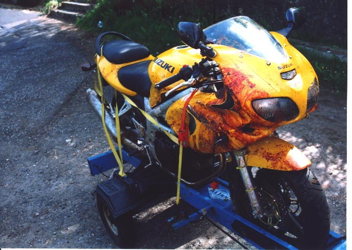

09/06/00 - EVER WONDERED WHAT AN SV LOOKS LIKE WHEN IT'S HIT A DEER? - John (johnhiggins@johnhiggins.screaming.net) found out first hand...
Don't know if you show horror pics, but here's why I missed the ride out. OK...I accept...it is a pretty good excuse...
While driving into night shift alongside the Gareloch, I was taken out by a suicidal Bambi leaping from the bushes. Luckily it was only a small(ish) deer but it still took me straight down with a bit of a slide up the road. Apart from damaged ribs and some general bumps and bruises I'm in one piece, but my insurance company is worse off to the tune of £2500, major items being front wheel, fairing, radiator and exhaust along with sundry other bits and bobs. Still waiting for the wheel and getting very impatient
to get back on. Perhaps I'll make it next year......

02/06/00 - MORE ON LOWER PEGS & REAR SET - Alex replies to Scotts posting.....
I've tried to look up the posting of Scott in the new 'forums' but have not found it, therefore I'm sending this by e-mail, hope you don't mind.
I think I've got a solution for Scott, who feels that the SV is too small for him to ride. Well Scott: I'm 2m3cm (6'8" if i'm right) and the SV fits me nicely. OK, after doing some mods that is. I moved the footrests back by some 6cm, and replaced the standard steer by an Italian 5 piece steer as used on Laverda triples in the eighties, also turned the steer-clamp on the upper fork-yoke by 180degrees. Together this resulted in a 10cm lowered and moved forward position of the steer.
I don't have a photo of my bike showing the result, but i've included a 'before' and 'after' pic of an SV I made on my computer before actually doing the mods.
Also I've included a drawing of the "rear-sets" I made (need two of them) out of 10mm stainless steel. (I know : overkill, but this material was available) BTW: sizes are in mm.Take off the original footpeg-sets from the frame, mount the home-made plates, then bolt the original set onto the SS plates. You will need an extended shift lever, and I've dropped the rear brake-light switch (don't use the rear brake anyway).Doesn't look professional, but works fine, and costs of are minimal.
PS: just received my BOS oval alu-sport exhaust system, still need to mount it, looking forward (a lot) to hearing and feeling the result, will also try the shim-'tric' in the carbs. I'll keep you posted.
Before Image / After Image

02/06/00 - SV IMAGES ON THE MOVE - Thanks Brian (RennBP@mfr.usmc.mil)...
Brian from Tennessee here again. I was riding the other day and my friend took pics of me at 70mph. Here they are.... I didn't make it to Deals Gap this past weekend because the weather was so bad, but as I was driving back down from Ohio last night I saw about 100 bikes, they were probably coming back from the gap. I did go down there last week and I was riding with a Y2k R1, a Zx11 and a new black bird and because of the roads and how tight the curves are I dusted all of them. All they saw was my exhaust all day.
Sure they would catch up to me on the straits, but by the time they would get near me I was laying the bike over for another corner. It felt so good. I had a good time beating them. They thought I was some superbike racer or something, but the bike is so light and has so much low power that I was the man, well maybe for about 20 minutes.
When we got to the end one of the guys said to me "Do you have your break lights disconnected?" All I said was "it's all about the rider" Just kidding, but the stopping power of the V twin is great..... I thought you guys and gals would like these pics.
Image 1      Image 2
