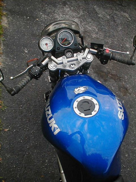

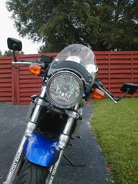

| 12/10/01 Christopher Mallardi Christopher_Mallardi@assurant.com has sent some pics of his SV. Looks very Cafe Racer. |
