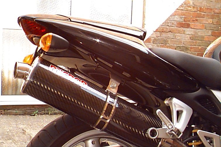

31/03/2000 - MICRON HIGH LEVEL SYSTEM IMAGES - Thanks to Emma (emma.dighton@domino-uk.com) for these...hope you get well soon...
It's Emma again - the one with the micron high level xaust. Whilst I have been laid up (bone graft - on the healing path now), I have been fitting a few bits and bobs - or rather mate Dave fitted.
I attach some piccies of the pyramid undertray we fitted - its nice, and I am glad, because after 8 hours fitting it flippin well should be! We had to cut some bits of the undertray away to accommodate the exhaust bracket,  and cut off the mud flap - so fiddley - allow at least a whole Sat/Sun to fit this.
I've got a purple engine bolt kit to fit, and I have also found a fybo-lite yoke cover (cos mine was getting scratched) and it looks really nice - some had the risers cut out for the unfaired model - there was only one  shape cover for both bikes.
But I think it looks really good - especially along with the seat cowl (also pyramid). I am gathering a few friend to come with me to your May 14th ride out, looking forward to meeting all the other SV lovers - so see ya all there.
 <<image08.jpg>>

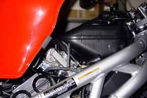

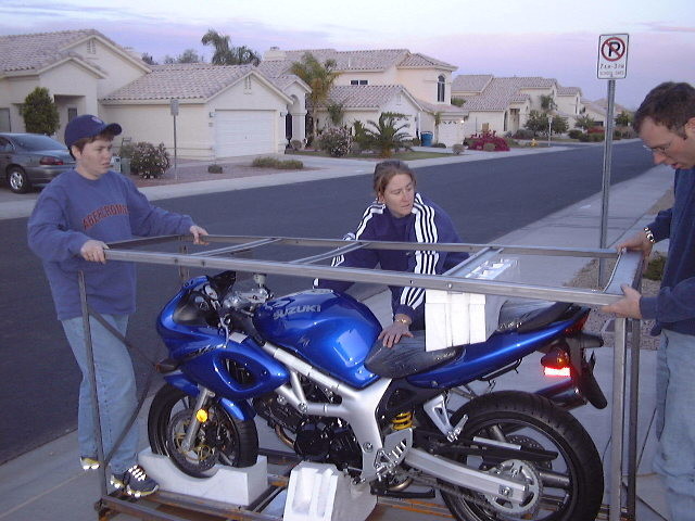

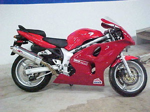

28/03/2000 - SV IN CRATE & MODS MADE - Thanks for the images Ed (edwinj@hotmail.com)....
I just got my Canadian SV650S last Monday. The pictures do not do it justice!! I guess I lucked out since it was not a recalled VIN. I just finished shimming the carbs and rerouting the tank overflow hose. I followed the instructions that were given on your site and my room mate and I did it in about 1.5 hours.
Any hints on the black plastic side covers? I had a very difficult time getting the little poppit things out. I undid one side and then just moved the other one far enough out of the way to loosen the seat mounting bolt. (I've not been able to get mine out either, I just pull the cover back and out of the way to get at the seat bolt)
When loosening the radiator I found only 3 bolts rather than the 4 that were quoted. Also, to loosen the top right bolt I had to remove the radiator cap. Contrary to what was also stated in an earlier posting my Y2K model did not have multiple groves on the needles.
When I removed the airbox there was a spout on the bottom that had a piece of tubing stuck on it that did not have an opening (open on one end, sealed shut on the other about 1 inch long). Do you know, or has anyone mentioned what this is for?
Here is are a couple of pictures of the bike, one is ok, the other not very good. I am in the center on the poor one, and on the far right in the other.
  Image 2

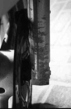

28/03/2000 - FORK CORROSION PICTURE - Dvaid (vid@totalise.co.uk)
A few people have been asking about the fork corrosion (Suzuki warranty claim pending), so here's a picture of the worst part, the bottom port of the left fork leg. As I said before the corrosion is working its way under the laquer, which is now flaking off. (this is not good, let us know what happens....i have a few small flakes and hope it doesn't get worse...)
On another subject, after 5100 miles the original MEZ4 rear is toast, so I've just had a pair of Bridgestone BT56s fitted. They're still at the slimey new tyre stage after 50 miles or so, but starting to feel good. Got to get them scrubbed in time for a track day on April 5th... <grin> I'll let you know more later.

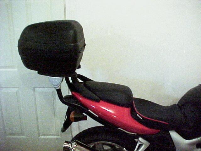

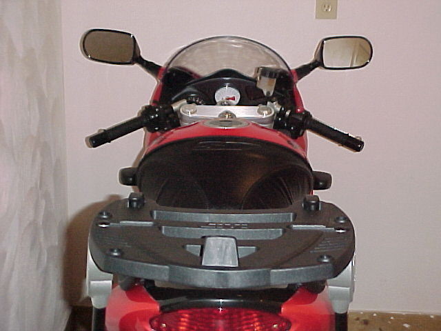

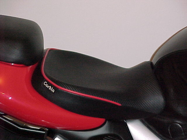

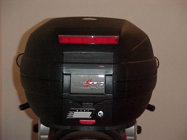

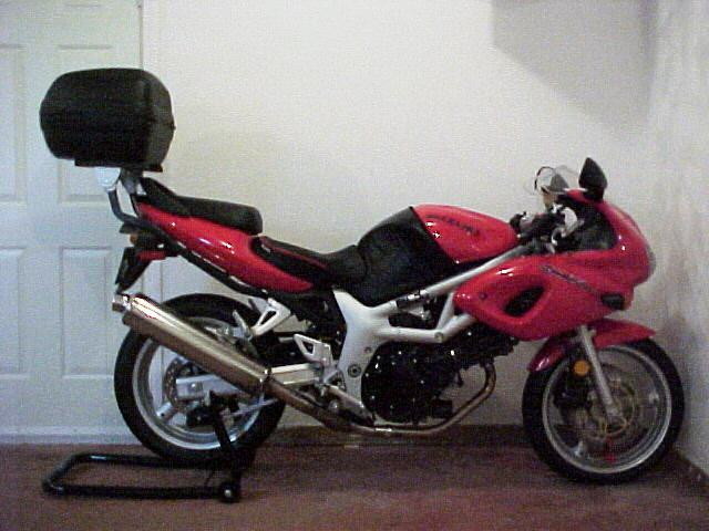

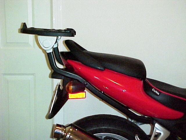

26/03/2000 - GIVI & CORBIN IMAGES - Thanks to Chad (tia@nb.aibn.com) for sending in his Givi and Corbin seat images for sharing...
Attached are pictures of my SV with the Givi E360 Topcase and Corbin seat installed. I am very pleased with both products and would not hesitate to recommend them to anyone who is interested in making their SV a better tourer. I am sending six different shots of my bike so feel free to use them however you like. (thanks)
Image 1       Image 2         Image 3         Image 4          Image 5          Image 6

26/03/2000 - THE BIG DAY IS HERE - For Carter (c.berlin@worldnet.att.net) it is anyway...
Well, today I take delivery of my 4 hours uncrated 2000 Blue sv650y. (Shudder Shudder Joy Joy) Thanks for the info on the recall and my dealer here in Colorado claims that all of the bikes being shipped now have had the service for the recall completed in the factory. Needless to say I'm going to want to get a little documentation on that.

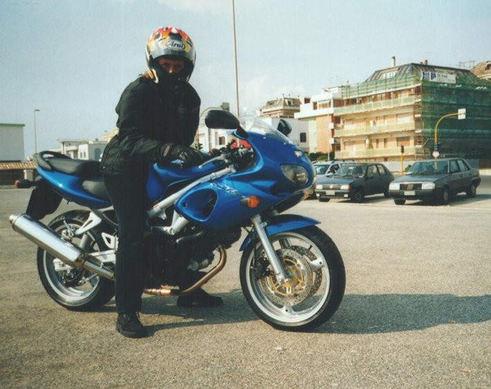

22/03/2000 - IMAGES - supplied by Veronique (diaboliq@libero.it)...thanks...

22/03/2000 - HOW TO: HIGH LEVEL MICRON OVAL ALLOY RACE EXHAUST - Many thanks go to Jonathon (Jonathan@zx7rr.demon.co.uk) for this How To.....they help so many people and are much appreciated....
Hello all, a small note for what its worth on the fidly bits I found whilst installaing a new ehaust on my SV650S.
I've fitted the Micron Exhaust today, it took me about 4 hours, in total. The midrange has improved as has the top end and the sound is very Ducati-esk. Micron claim that no adjustment to carburation is required, but you can if you want.
The installation went quite smoothly but there was more work than I realised. The side panels and seats have to be removed to get to the rear brake cylinder which is partly used to affix the exhaust mounting bracket. On removing the side panels I had to use an impact driver to unscrew the four crosshead rubber mounted bolts. These are very firmly fixed to the frame.
To remove the side panels don't forget the two small screws near each rear indicator. These prevent the panels from popping off the rubber mounts which are exposed when you take the rear grab rail off. The rear seat locking mechanism on the left hand side is the last bit of attachment between the bike and the left side panel. un-pop the cable mount and rotate through 180 degrees this then slides out and the panels can be put to one side.
Next having soaked all the mounting bolts with penetrating oil for at least 1 hour you can start loosening all the bolts. This does not apply to the join between the front pipe and the rear. I worked from the back of the bike forwards loosening but not removing the exhaust. Once all the bolts are loose, leaving the rearmost bolt at the tail end that the front two cylinder end nuts remove all the bolts in between. Then whilst supporting the exhaust with your foot remove the remaining bolts. The exhaust then after some rotating back and forth comes off as one unit.
Next remove the stud screws at the cylinder end, this is achieved by locking the two nuts removed back on themselves and then unscrewing each stud. Micron say that this is necessary because they will have been damaged during exhaust removal. In fact you remove them because you will not be able to fit the front section of the Micron system with them in place. I used lots of exhaust paste during assembly. The system is a very snug fit with the rear suspension units and when they say do not tighten until later follow their instructions. I found I had installed the front section hard up against the supension linkages. Dohh!
Basically assemble the rest of the exhaust unit "loosley". Then when complete from the right hand side of the bike get a willing assistant to pull the lower section of the exhaust away from the bike whilst you go around to the other side and tighten the bracket between the original stem pipe poking out of the rear cylinder and the Micron down tube. This rotates the pipes away from the swing arm and rear supension units. Quickly tighten the rest of the nuts and bolts before the exhaust sealent paste sets.
Then reassemble the rest of the bike. I used lock nut everywhere once I'd cleaned off the penetrating oil. Once complete get willing assistant back into the garage / workshop and fire it up. Wow! Smiles all round.
Go for a small ish bike run to check it out for leaks, sound, acceleration and hapiness factor.
Got the Micron Oval Alloy (Not for road use) down pipes and end can at the Scottish bike show for £250.00 inc delivery. Definately worth it.
I'd like to thank all the people who wrote encouraging me to do this by not telling me everything but describing the stub pipe used during this install, which remains from the original Susuki.
If I can do this anyone can.

22/03/2000 - CARB SHIMMING COMMENT - Thanks Andy (andy@number61.freeserve.co.uk)...
I have been watching this web page for approx one year now and would like to   congratulate you on creating a great site. I first saw the SV in an advert about a year ago and was immediately smitten, reading your site confirmed that this was the bike for me and I finally got a yellow SVS on March 1st, since then I have done about 900 miles all of them with a big grin.
Today I followed the How To on carb shimming posted by Brett (which incidentally was very good and much appreciated) and found that my 2000 SV does have slots in the needle, I take it this is one of modifications made to the 2000 models. I moved the E clip down one notch, this is about the equivalent of two thicknesses of the washer, is this likely to cause  any problems? The exhaust is still the stock system.
I have only been able to take the bike out for a short run but it still feels like there is a flat spot around 5000rpm, above this the bike seemed to pull much harder and I was having to change up much earlier than I have been used to.

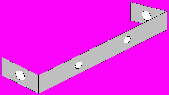

22/03/2000 - INSTALLING A GIVI TOPCASE - Thanks to Chad (tia@nb.aibn.com) for the details...
I installed a Givi E360 Topcase and Monorack on my SV yesterday and am happy with the results. No more wearing a backpack jammed with stuff for me anymore. Installation was easier than expected except for two minor problems -
#1 The four metal pieces which go inside the rear frame rails had to be filed to fit and
#2 The four little rubber pads on the base plate had to be removed because the case would not snap into place, even with two people pushing.
I considered the rack offered by Suzuki here in Canada which installs in the place of the grab rail. The benefit to this rack is ease of installation and removal (two bolts) but the downside is you have to buy a soft tail bag to be bungeed in place. I travel with luggage 90% of the time so the Givi with its locks and sturdiness was right for me but I would suggest the Suzuki rack to anyone who does not want to use the bungee rails under the seat for fear of scratching the tail bodywork. I still couldn't find a price for the Suzuki rack but my Givi with case and rack cost $279 Canadian. I tried to send pictures earlier but it didn't work. Any tips? (any error message?) Thanks to Kevin for the great site and the readers who have responded to my questions in the past.

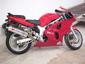

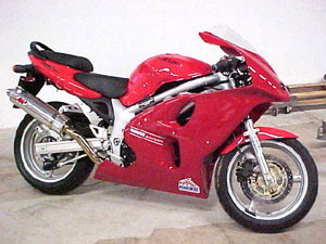

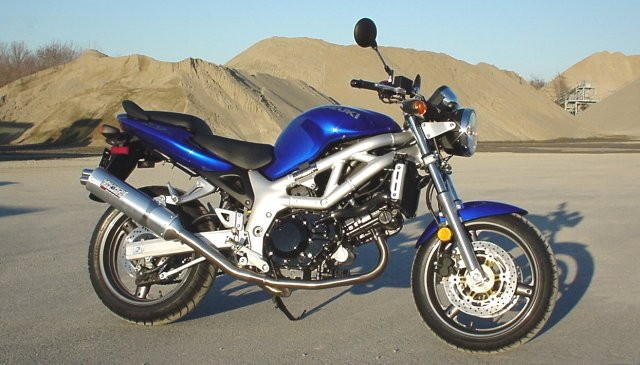

17/03/2000 - SHARK SKINS FAIRING - Thanks Marc (harshman@ix.netcom.com) for the images...looks good...
I thought you might like a few pictures of my SV650 with Shark Skins and M4 high pipe.

17/03/2000 - FRONT END SPARES - If you can help out (waregh@free.fr) then please do..
I need help !!
i've an bike crash with my sv & the front tubes are out. Nobody for the moment make it in france, only original but it cost too much..
Do you somebody who can sell one to me. ?  Only the front tubes are out, i've got the spare oil etc....
Thanks for your help, soon a tuning web site of mine .
You can have a look of my ex bike on http://waregh.free.fr    The sv will become a tuning one too..

15/03/2000 - HOW TO : SHIMMING EXPLAINED - Many thanks go to Brett (bretbeau@westol.com) for this detailed posting on a subject many are asking about...
As I have had a flood of emails concerning this issue, I have decided to write one email for all to share. I see that I have sparked new interest in the M4 pipe, think they will give me commission? Tell 'em Brett sent ya! :) (and if you buy an SV tell 'em I sent you...but it won't do me any good!)
Okay, here it is. ( If I forget anything, please let me know as it is a little late tonight.)
Start by removing the seat - this allows the tank to prop up easily. Remove the small allen screws on the side cover plates under the seat, then the larger allen bolts that hold the seat on. Seat should be removed by sliding it toward the tank and lifting up the front.
Next, remove the two allen screws that attach the tank in the front by the forks. Use the prop supplied with the bike ( In the rear storage compartment for you new owners) and prop up the tank. You'll now see the massive air box.
NOTE: While you have the tank propped up, now is a good time to address that "water in the tank" cure. ( See Kevin's/Ian's postings on the fix. ( Yes, I did that too. :) )
Start by finding the phillips screws that are part of the airbox clamps that clamp it to the carbs. ( Rear one is on the right, front on the left side if sitting on the bike if memory serves.) Get some "liquid wrench" machine oil and put a few drops on the threads of these screws. They are VERY stubborn and this overcomes this problem. Let the oil soak in for 15 minutes or so. ( Go get a drink and check your messages.)
Next, use a phillips head screw driver and loosen the screws. Be careful not to strip the heads, apply steady firm pressure. They'll give in eventually if you are patient. ( Note, if you can't remove them, email me and I'll explain an alternate method to get around this problem. Suzuki has a fail safe in the event that the screws are "frozen")
Once the screws are loose, locate the crank case breather hose on the left side of the bike. It attaches to the air box on the left rear side. Remove the hose and lift the air box off the carbs. The drain hose for the box is long and hangs down the center. If there is a little resistance to lifting off the box, this tube is probably meeting some resistance. Find it and wiggle it while pulling the air box up, this will allow removal.
You are now looking at the two carbs. At this time, use some aluminum foil and cover the inlets for now. ( Keep dirt out of it.)
Next, dismount the horn from the frame in the front and move it out of the way. ( 1 bolt 10mm) Now loosen the radiator. There are 4 bolts that hold it on. ( Two bottom, two top. 10 mm) This is necessary to keep from having to disconnect the throttle cables. After the radiator is movable, remove the mounting bolts for the fan assembly. There are I believe three of them, two bottom, one top. The top one is accessible via the interior near the carbs. ( Will have to use a 10 mm wrench due to space constraints.)
Now that all that business is loose and "mobile" slide the fan assembly over toward the right side of the bike, enough to get it out of the way, but don't damage the radiator fins.
Remember that "liquid wrench" you used before? Put some on the clamp screws that attach the carbs to the intake of the heads. You'll need a long phillips screw driver to eventually loosen the front clamp. The screw head faces the right side of the bike. Walk over to that side and look in the lower area of the carb and you will see it hiding in the recesses of the interior. The rear carb clamp screw faces I think the left side of the bike, and is easily seen. ( Don't worry, these screws are easier to turn than the ones for the air box.)
Loosen the clamp screws and carefully lift the carb assembly up. It will easily pull off the intake pipes. It is now somewhat moveable / loose.
FOR THE FOLLOWING, GET A LARGE CLEAN PAN / BOWL AND PUT A PAPER TOWEL IN IT!!!!!!!!! ( Trust me...)
It might be a wise time to recommend going to the hardware store if you do not have the next item. Since the front vacuum cover is difficult to take off given the limited space to get a screw driver in to unscrew the mounting screws, I used the phillips head tip to my black and decker screw gun in combination with an 8 mm wrench to form a 90 degree phillips head screw driver! ( Yeah, I've watched shade tree mechanic...) The screw gun tips can be bought at a hardware store for a couple bucks. I recommend the ones that have about a 1 inch shaft on them, they seem to work nicely.
Now with you new ( Maybe even patentable?) screwdriver "wrench", locate the two screws that mount the vacuum cover/plate. One is on the bottom right, the other at the top left. Apply gentle steady pressure - they will eventually loosen. I recommend starting with the bottom one, then removing the top one last, as the vacuum plate has a weak spring inside.
Placing your free hand on the cover to hold it down, remove the top screw. ( Put both screws in your paper towel lined pan.) Gently ease off the pressure and allow the vacuum cover to be removed. Place the cover and spring in your "parts bowel".
Next, gently grab the rubber diaphragm and pull it. It will easily unseat and the slider will begin to slide out with the diaphragm. (Forgive me I can't spell!) (luks OK ot me...) Carefully pull out the slider/needle/diaphragm assembly and put it in the "parts bowel"
Looking inside the rubber diaphragm, you'll see a plastic tab. Grab the plastic slider with one hand, then with a pair of needle nose pliers in the other, gently grab the end of this tab and pull on it with a slight twisting motion. * Careful, there is a small spring that can pop out if you do this too abruptly - easy is the message.
Put the tab and spring in the parts bowel, then turn the slider upside down - the needle, washer, (and spring If not removed with the tab) will fall out.
With your needle nose pliers, GENTLY grab the blunt (non tapered) end of the needle and with your other hand pull on the plastic spacer under the e clip. May have to use your finger nails to get under it and pull it off. Once removed, take that metal washer and put it under the e clip, then replace the plastic spacer on top of it. ( You'll note that this washer WAS on top of the e clip when you pulled out the needle from the slider, it's now under it.)
Drop the needle back into the slider. Put the small spring on the nub of the plastic tab, then with the needle nose pliers, replace the tab in the slider, pushing with a gentle twisting motion. You'll feel the tab seat into place.
Now take off the aluminum foil on top of the front carb. Re-insert the slider back into the carb, making sure to guide the needle into its hole by looking into the carb. The rubber diaphragm has a small rubber ring on the side of it that lines up with a small peg on the bottom right of the carb.  Make sure the diaphragm is properly seated into the carb lip with you fingers. ( It will seat flush in the lip of the opening on the carb.)
Take the long spring and vacuum cover, place the spring back into the carb ( It goes in the center of the slider assembly.) and place the cover on the carb. Make sure it is seated properly. ( Note: Replace the vacuum cover/plate and the long spring together as one piece.) Mount the vacuum cover with the mounting screws and tighten snug - but don't torque them down real hard. You want it snug so that it seals.
THE FRONT CARB IS NOW SHIMMED!
Now do the same to the rear carb in the same fashion - this should take you 2 minutes as you are now a pro and the rear one is more accessible.
ONCE THE CARBS ARE SHIMMED:
Remount the fan to the radiator
Remount the carbs onto the inlet pipes and tighten the clamps
Remount the radiator
Remount the horn
Use a paper towel and wipe the top intake area of each carb to remove any contamination ( dust, etc... don't let any dirt fall into the carbs!) Use another paper towel and wipe the attaching area on the air box. ( You may also want to remove the air filter at this time and clean it according to the owners manual while you're at it.)
Replace the air box onto the carbs, be sure to get a snug uniform fit all the way around. You may have to wiggle the air box and use a small flat head screw driver to make sure the lip seals all the way around. ( Be gentle with the screw driver, don't mak the carb surface or the rubber surface.) Once you are convinced you have a good fit, tighten the clamps that hold the air box onto the carbs. Frequently inspect as you tighten to make sure you have a seal all the way around and that it didn't pop up. ( It took me three attempts before I got it right.) Might want to try one at a time if doing both at once proves unsuccessful.
Once the air box is mounted, re-attach the breather hose for the crankcase. Make sure you have all your tools and have no "extra" parts, then lower the tank and bolt it back onto the frame. Replace the seat, bolt it down and you're done. ( The seat may be challenging to put back on, be patient and start both bolts at the same time. The seat is a snug fit so be patient is a virtue.)
You have now completed the carb shimming. Start the bike in the normal manner, allow it to warm up. Strap on your gear and hold on!
Hope this helps, any questions email me at Bretbeau@westol.com

14/03/2000 - CORRODED FORK UPDATE - David (dmingay@maritz.co.uk) updates us on his previous posting from below...
Took my SV back to the dealers (M/City Fanborough) to show them corrosion on the lower laquered alloy fork legs. Good news - they took photos and bike details to submit a warranty claim to Suzuki. I'll have to wait a couple of weeks or so before I hear anything, but with any luck I'll have some shiney new forks in time for summer.
Thanks to the people who responded by the way!

14/03/2000 - LOWER FAIRING & HUGGER - Thank you Andrew (adreynolds@cwcom.net) for the comments...
I thought I would let you know my experiences with the official Suzuki lower fairing.
I ordered one at the beginning of March for my blue 2000 model SV650S. It only took the dealer 6 days to get it!
I fitted it Saturday and didn't really have any problems at all. The instructions were simple and I completed the job in about 2 hours.
I think it looks great and the colour match is perfect. The only slight niggle I have is that I can't seem to get the gap between the upper and lower fairing the same both sides, but I didn't really try very hard as the weather was great and I wanted to get out on it.
Also I fitted a PowerBronze hugger recently. This was a bit trickier than I expected. You have to fit a bracket on the right hand swing arm using the existing bolt that holds the break pipe in place. I managed to fit the bracket but fitting the hugger to it was difficult because you can't get your fingers between the hugger and the wheel to get the nuts on. I ended up taking the bracket off and fixing it to the hugger first and then connecting it to the swing arm.
I had the same problem as in a previous mail where the hugger is impeded by the built in muck protector, but it only deforms the hugger slightly so I didn't need to take it off.

13/03/2000 - JACK-UP PLATES FOR SV - Thanks for this Doug (Douglas.pepper@kpnqwest.com)...are Jack-up plates rearsets used to push the footrests back and up?
Just a quick warning to anyone who buy's Jack-up plates for their baby. I ordered some and duly received them. Had them sent to my UK address and brought them over to Holland with me. Started to fit them, it  seemed an easy job. Screwed in the top bolt, but the bottom one would not fit.
Possibly because I was tired, I managed to cross thread the bolt in the frame. I then measured the distance between the to holes on the plate   and the ones on the rearset. The jack-up plates were a couple of mil out. Quick butchering with a file sorted this, but left me with one hole on my  frame with a cross thread. I now have to re-tap the hole at some stage. Moral of the story...
1. Don't work on your machine late at night after flying in.
2. Check any bits first to see if they fit.
Oh and it looks like my hugger has finally turned up (after a two month wait). I pick it up in UK on Monday. Must be a lot of people wanting these, as the guys at M & P advised that they could not keep up with demand.

13/03/2000 - M4 EXHAUST SYSTEM JETTING - Brett (bretbeau@westol.com) is mighty pleased with hows it's gone...
Well, there was a break in the weather and I did the needle shimming by moving the washer under the "E" clip. All I can say is I've never been happier with a pipe and jet job!
The straight bolt on of the M4 not only made my SV sound like a ducatti, but gave me a surprise when I blipped the throttle in an intersection down town. I must have given the citizens a nice show. :) Then I shimmed the needles last week - all lean spots on the rpm band are gone! Pulls super strong from bottom to top. I must say that wheelies are no problem, in fact I find myself being conscious to try and avoid pulling the front end up on hard acceleration. Bike runs like a dream and doesn't skip a beat.
The fit of the pipe is perfect. ( Must make sure your clamps are tightened to specs and aren't meeting over any tube slots to avoid leaks.) Well worth the money. I got mine for $450 US from a dealer in Beaver falls Pa just outside of Pittsburgh. ( Saw it a little cheaper on the net for those comfortable with that route.) But for those looking
for great performance gains, good looks, and easy "rejetting" this is the way to go hands down.
M4 has changed their instructions to read "shim needles 0.020 and turn the pilot screws 3 turns out." My SV, being unfaired and the carbs stamped with "F2" means that the factory preset is 2 1/2 turns out. I have not messed with the pilot screws, and probably won't at this point as I am content with it the way it is now. Guy at M4 told me that the new recommended set up using the stock hardware gave the best performance results over aftermarket jet kits. * Better dyno numbers and track runs.
Happy riding as spring is less than a month away!

09/03/2000 - REPLY TO MPS HUGGER FITTING PROBLEM - Thanks Roy (roybach@blastpast.fsnet.co.uk) for this...
I have fitted an MPS (NWS) Hugger,without problem. The bolt that is giving "ddeans" hassle is if my memory serves me correctly, is 10mm. and is best removed using a longish BOX spanner, as the channel that it sits in is very narrow. Box Spanners are relatively cheap and are also useful to remove the front mudguard (fender) on the SV as well. but first check your SV tool kit as there might be one supplied.
Also, this on the subject from Russell (Russell@gladwish.fsnet.co.uk)...
I had the same problem with thr "crap deflector". I can be got at with a 1/4" drive 10mm socket on a short extension bar. It's fiddly but it works.
And finally for today this from Gustaf (Gustaf.Nygren@swipnet.se)...
Some tips for David, I had to change the mud guard (no, I don't want to tell you why...), I used a 1/4 socket set with a ~4 inch extension and a socket - I can't remember if it was 8, 9 or 10 mm. The bolt is located in the middle of the mud guard in the groove accessible from the top.

02/03/2000 - SV PAINT - Following on from the yellow and red paint codes being posted Michael (michaelsawyers@totalise.co.uk) comments...
Thanks for the note. Standox took a panel from my SV650Sx to Spain!! and made up some expensive paint - £25 for 100 ml. B..... hell! When the paint shop sprayed it they found it too thin, too pale, and too pearly so that was a waste of time, three weeks to be exact. The damage was very superficial so the whole issue is turning into a farce. They are going to try again.
02/03/2000 - COMMENTS - from Viktor...sorry I deleted your email address...
After two months of waiting I finally got my new blue SV!!!!! I live in the states so it is the naked version.
Few details I noticed:
- the bike comes with factory installed chain guard that has the label with the tire pressure recommendations on it. I thought that there was no chain guard at all on the '99 model. Not sure here. (yes there is...with tyre pressures on it...)
- the wheels ARE BLACKISH DARK BROWN instead of silver. I like the silver ones better but those are nice too.
- the first impression is unforgettable: Suzuki really did an outstanding design job.
Where I can buy fender extender in US, I can ? and what is the website of the makers of the Targa quarter fairings? I definitely need those two.
Now I have to take the baby through the break-in period. But those are sweet sorrows :-))

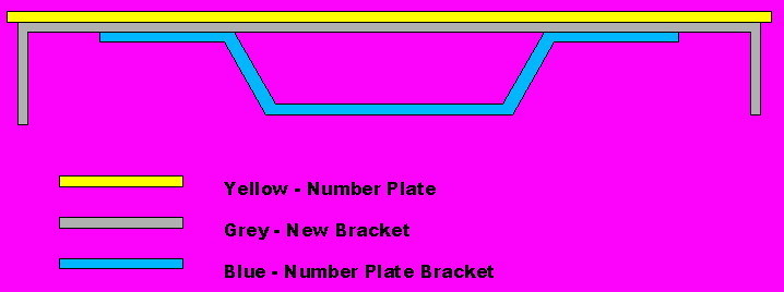

02/03/2000 - SOFT PANNIERS FITTING - Another 'how to' from Ian (ian@netgates.co.uk). Thanks very much!
Finally, I've managed to move the rear indicators so that my Oxford Sport panniers sit properly.
The idea is to make up a short, squat U shaped bracket, (2.gif) as wide as the number plate (9 1/2" on my bike) and about one inch high to sit between the number plate and the number plate mounting bracket (as per the plan view 1.gif). The end holes for the indicators are 12mm diameter, the number plate holes are about 7mm. I managed to get some stainless steel about 1.5 mm thick, you can make it out of pretty much anything. If you use normal steel, then you'll have to treat it/paint it to stop it rusting. If you use plastic, don't use anything too brittle, and use something that you can bend. The easiest way to bend plastic is to warm the line of the bend over a candle or nightlight, but don't overheat the plastic, otherwise it will bubble or burn.
The other thing to note is that the holes in the number plate may different distances from the edges of the plate. The number plate bracket gets around this by being slotted. If you can make your bracket like this, then so much the better, otherwise, be careful with the marking out. In my sketches, I've drawn the bracket with perfectly sharp bends. It's impossible to make like this, the bends must have a radius, so take this into account when marking out.
When the indicators are moved to their new position, the wires are not long enough to reach the wiring loom. I had to add about eight inches of cable by cutting the wires in the indicators about two inches from the bulb holder and soldering in the new cable. I insulated it all with heat shrink tubing. I guess that you could probably do it with crimp connectors or bullets as well.
To fit the pieces.
Unlock and remove the pillion seat.
The wires from the indicators run up inside the pillion seat compartment and plug into the wiring loom just in front of the tail light with a couple of small, two pin connectors. On my bike, one plug is grey, the other is black. If you can reach these, then fine, I found that I had to remove the front seat and the whole of the rear bodywork, thus:
Remove the two side panels and the rider seat (as per the handbook).
Undo the two self tapping screws under the seats which hold the left and right plastics together.
Remove the grab rail.
Remove the four screws through the rubber seat buffers. Take the metal spacer tubes inside the rubbers out. The front rubbers will come away, the rear ones won't.
Remove the two self tapping screws just inside where the rear indicators screw through the rear mudguard.
Remove the rear bodywork i.e. the coloured left and right sides and the black piece above the tail lights as one unit. It won't come away from the bike completely because of the cable from the pillion seat catch to the lock. Rest the unit on top of the bike.
Now you can mount the bracket, just take out the two plastic number plate bolts and reassemble with the new bracket between the number plate and the original bracket, with the side pieces pointing forwards. Don't do up the number plate bolts too tight, they're only nylon and they will snap easily. Mount the indicators in the new bracket, preferably with shake proof washers. Run the cables back up through the original holes and reconnect the plugs. If you had to take the rear bodywork off, then put it all back together.
Click for Image 1   and      Image 2

02/03/2000 - CORROSION - Thanks David (dmingay@maritz.co.uk)...
Just thought I'd drop you a line to see if anyone else has had corrosion problems on the front forks. This was a bit of a shock to me as it hasn't been used over winter at all. It's been kept outside under a canvas cover since the end of November, but when I uncovered it last week, I've found the metal is coroding beneath the laquer in several places on both fork legs. It looks terrible, and to my mind, is unacceptable quality.
I previously had a 600 Bandit (they have painted forks) and ran it through 2 winters with no such problems. Anyone else suffering in the same way? (I have some marks at the top of one of the fork legs but it's not too bad otherwise.....mind you, I should have bought shares in WD40 !)
I'm going to try warranty claim with the dealer, but don't hold out much hope, though I'm sure that if I tried a trade in, they'd reduce the price 'cos of the state of the forks ...!
Other than this (major) disappointment, and a faulty battery (replaced under warranty) my SV has been great.
It's now obvious twelve months since the SV was launched that corrosion resistance is all but non-existant....pity....a bit more effort by Suzuki could have lessened the effects we're seeing a great deal.

02/03/2000 - MORE RECALL COMMENTS - Thanks Locke (lperkins@holmberg.com)...
I picked up my long-awaited red bike on 2-19-00, and yesterday (2-21-00) read with dismay the recall information on your site, which I had just found. I immediately called my salesman (the owner of the dealership) who was blissfully unaware of the recall, but who promised to check into it. Since my serial number fell just inside the range shown in the Suzuki letter, I faxed him the pages from your web site which detailed the recall and showed the numbers.
But happily, he called back this morning to say that when the bike was uncrated last Friday, it had a notice taped to the seat saying "Product Update Completed", which he said meant that the engine modification which was the subject of the recall had been done (somewhere) before the bike was shipped to him. He said all the service bulletins and recall notices are routed straight to his service department and they hadn't informed him.
Well, this was good news, but it leaves the new buyer (me) without any documentation that the recall service has been done. I'd suggest anyone who has recently taken or will soon take delivery of a new SV check with their dealer to make sure that you know whether that recall service has been performed and that you get documentation of that it's done when it is in fact completed. If you try to sell your bike, any savy buyer will want to know not only IF the service has been complied with, but WHEN in
relation to the delivery date of the bike. Fortunately in my case, there's still snow on the ground here so all I can do is sit on the bike in the barn and make motor noises with my lips, and the odometer still says 00000.1.
I've asked for, and he's promised to supply, a letter on his letterhead stating that the recall has been complied with., and I wlll attach it to my title.

02/03/2000 - FORK THUD AND TYRE WARNING - Thanks Davy (davyf@freenet.co.uk)...
Last December & January I told you about the gear leaver problem. Well I've had to strip and clean it again, it seem that the salty water is washing out the grease and corroding the aluminium nipping the plastic bushing against the steel spiggot. Once the leaver stops the leaver returning to the tart point the bush needs replacing.
About the frontend noise I found it is due to the fork internals knocking together. There is the spring, washer, spacer (which is flimsy & main suspect) & in my case extra spacer I replaced my original extra spacer for a solid spacer (10 mm) and the noise just got worse. I am considering replacing spaces & washer for a single thicker spacer. Unless I see a springkit I hate sending away for things.
Here's a warning, I have a pair of Michelin high sport super sticky tyres when cold they are the worst tyres I have ever used. wheel spins when pulling away, brakes away when cornering even slowly, skids on braking & closing throttle. In fact I have just thrown the SV up the road (bone dry) pulling away from a junction on a deserted street. I have used this particular junction thousands of times.Pulled out bike did a 360 degree an threw me about 4 meters. snapped both brake levers, right foot rest hanger, the foot rest its self was twisted 45 degrees & bent handle bars. I did not feel a thing until I hit the ground just visually noticed everything going round. I been riding over 20 years with 6500 on this bike with metzler & pirelli dragons on it. Tyre is ok after a couple of miles but most people will be at work by then. I will be using Bridgestones again after this.

02/03/2000 - LOWER FAIRING AND SEAT GEL - Thanks Keith (keith@robichau.screaming.net)...
I've just picked up the new Suzuki accessories catalogue from my local dealer (they've only just received them) and I've scanned in the picture of the lower fairing and the gel seat (I've ordered one of these). The lower fairing costs £209 (including VAT) and the gel seat costs £109.
Click for fairing and gelseat images
