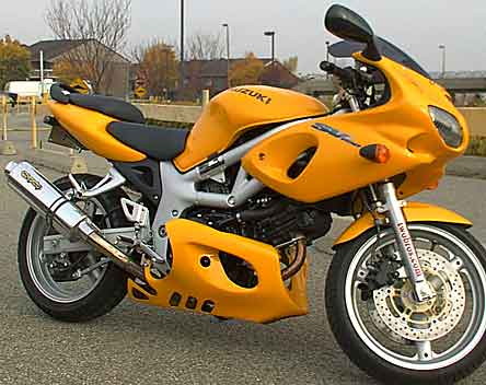

Hello there just to let you know about my web site www.zorstec.net any chance of a bit of a write up on your site? and a link back? regards and thanks for your time Andy. I've had a look at Andy's site and I was impressed with the number of different designs available. Well worth a look. These two shots should wet your appetites. I've left the yellow one in the large format because you need to see the detail. I'll add the site to the links page. |

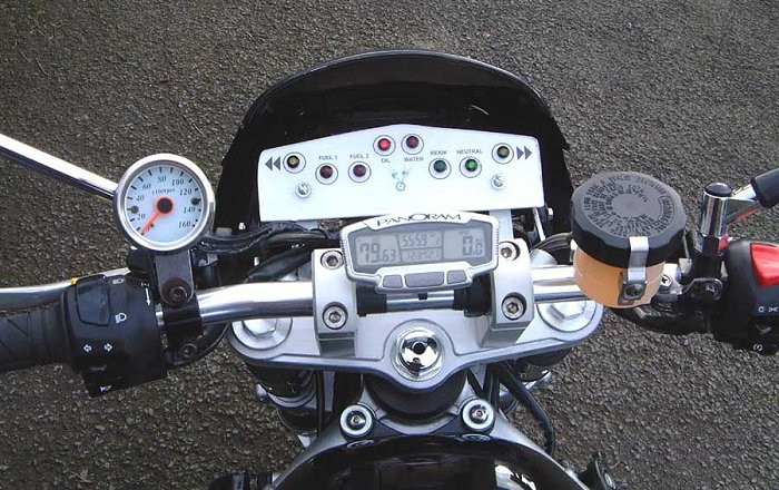

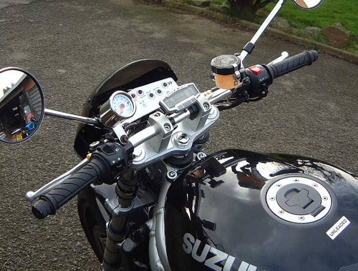

Feb 17th Some more info on
the Panoram device mentioned in Robin
Maddern restoration below.
The thing on the dashboard is the speedo, you can see the cable to the magnet on the front disc if you look closely.. it's from Halfords and was the only one with backlight illumination.. making it legal..! also many of these speedo's read to 120MPH+ and are extremely accurate.. much more so than the standard clocks! It also incorporate 17 functions with useful stuff such as Odometer, riding time, average speed, trip, accumulated riding time, stopwatch, clock, countdown service interval reminder, the max speed you have ever reached etc. etc.. Very very useful for £42.. also can be removed easily to prevent theft... Highly Recommended. PS. I'd say it was a useful thing to have anyway.. as well as your speedo. It seems to be extremely accurate although the speedo does take 1/2 sec to update the speed (it needs two revolutions to compute each time). The Clock etc is rather useful too. Some useful info: the front wheel on an SV 'rolling diameter' with correctly inflated original Metzler tyre is 584.2mm (as near as dammit). this multiplied by Pi (22 divided by 7, or 3.1428571) is 1836mm This is input into any computer when you have installed it. The readings are then very very accurate. There are a couple of articles on the web I found when I did a search on 'Panoram computer'. Thanks for a great site and letting me contribute. Robin. From Neil Bowden . Hi john regarding the trip computer on the restored sv650 that was wrecked i have found this site that has info on the Panoram bike computer http://www.atvcost.com/panoram/panoram.htm could you add this link to your comments for reference of others i am not an owner of a sv650s yet but thanks to this site and svrider i plan it to be my next bike. Neil Bowden Brisbane Australia |

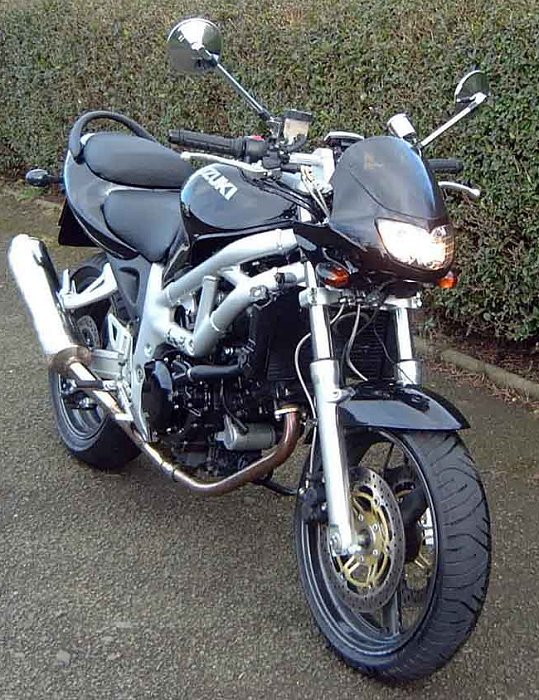

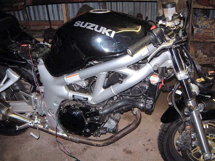

Feb 14th Robin
Maddern has sent in some photos of his restoration job.
I thought people might be interested.. It took me a month to do this: Before and after pics included. I bought a Y reg SV650S as a write-off from a specialist bike breakers. It was a catagory D insurance loss (i.e. cosmetic damage only, nothing structural at all). It had no fairing, lights, indicators, mirrors or clocks... also some other scratches were about and a broken hanger and a dinged exhaust finished off one sad SV. I bought it because A: I like a challenge and B: It was registered new 1/5/01 and written off 11/5/01 i.e. this bike had been on the road for only 8 days and had done just 652 miles. The previous owner was contacted for this history as the clocks were missing.. it was on the way back from it's first service when.. ''sorry mate, I didn't see you''.I made the dash and repaired all the damaged wiring myself (I'm an electrical engineer). Everything else was either sourced at my local friendly breakers, bought new or made. If you have any questions, please ask... apart from the ugly subject of money that is... What a top bike though.. And that's from someone who's last bike was a VTR1000. Robin Maddern http://www.robmad.com P.S. When I printed out my own dash I
used the logo off this site as an emblem underneath the lights.. you can
see it in the dashboard pic.. this is because of the help members of the
site gave me to make this project possible.. I was sent a really good
wiring diagram that made the job a lot easier. Thanks, Nice neat job Robin, must be very satisfying. I like the little gizmo attached to the handlebars. I assume this is an elaborate trip computer? John |
