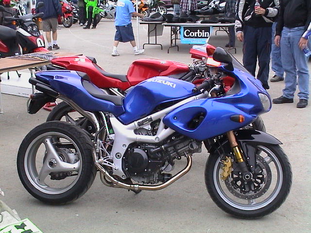

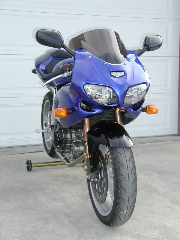

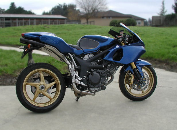

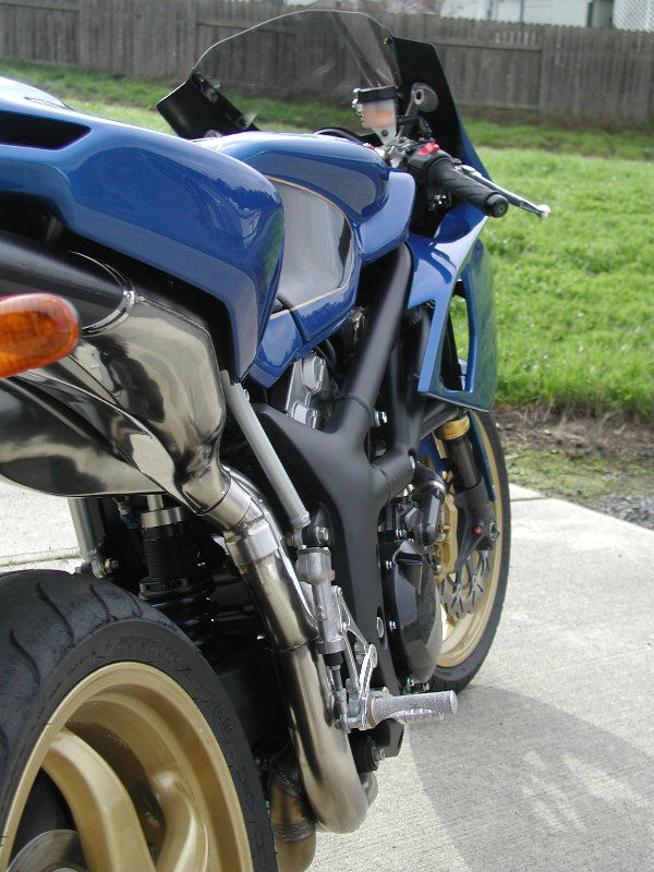

So this project began, innocently enough, with a front-end swap. If you couldn't tell, I'm a sucker for a pretty face. I could have upgraded the stock front end but was seduced by the inverted look. Had to have one on my SV. Motomorphic helped me source a complete 2001 GSX-R 1000 front end. I like the look of the gold tubes and the TiN on the sliders. Those 6 piston calipers look great, too. |
During the conversion, I thought I'd need to get a set of TL-S bars to get the same rise and clearance as the SVS bars. It turns out that the stock GSX-R 1000 bars work fine. They are about 1" lower but all the controls and cables clear everything just fine. |

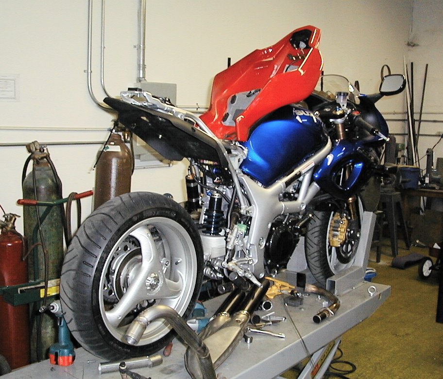

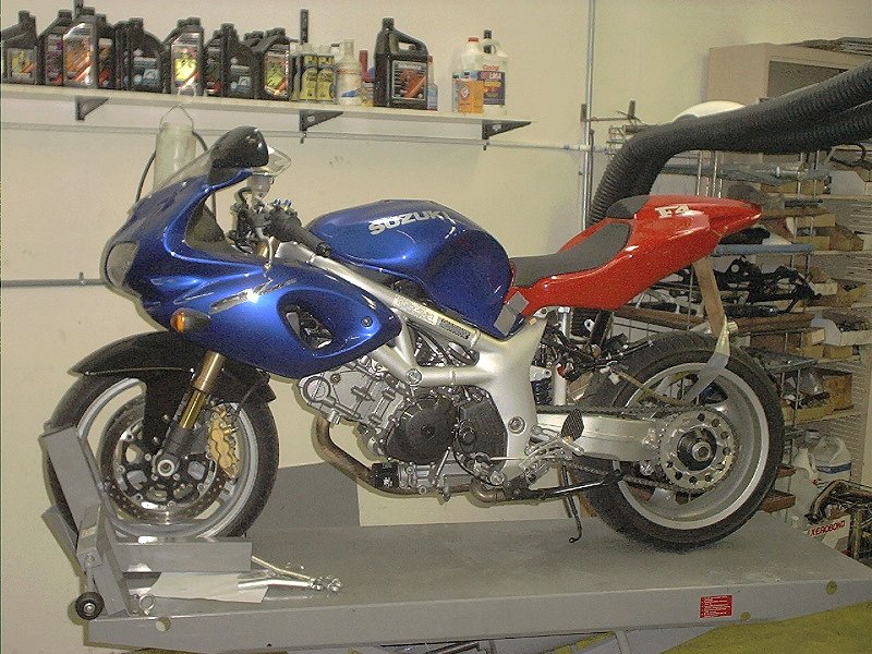

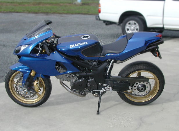

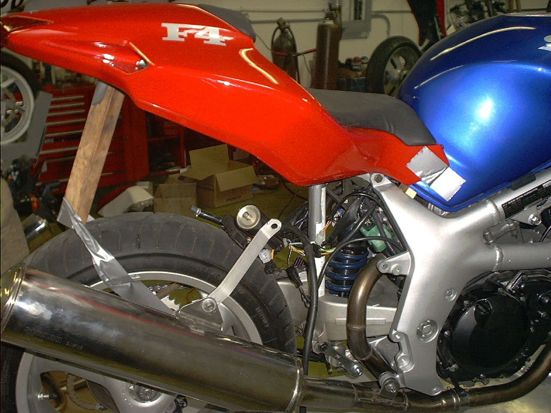

So, with the suspension sorted, I started thinking about the next set of modifications. I was surfing the web one day and I saw what was clearly a Photoshop-modified picture of a red SVS with an Agusta MV F4s tail pasted onto it. To me, it looked great. I thought, "Now we're talking!" and my search was on |

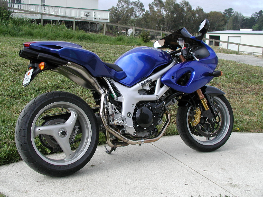

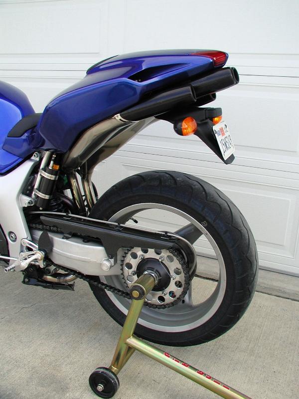

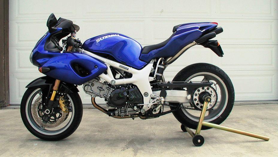

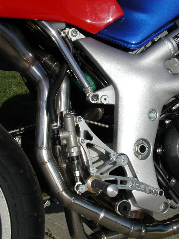

Now, those of you who want a single sided swingarm on your SV, have no fear. The mid ‘90s VFR 750 arm comes with the boss set up essentially the way you need it. All that’s required is to widen the boss and fit the appropriate bearings. OK, it requires a bit more than that but it’s a great deal easier and faster to fit than the RC 30. The Motomorphic SV has the VFR arm on it and it was a far simpler mod. Ah, the joys of ‘going first’… Anyway, the RC 30 arm looks great, it fits great and it works great. It confuses people when they first see it. Most people ask if it’s a Ducati swing arm. I guess because they recognize the rear wheel as Ducati. Plus, based on my conversations with people, it appears that not many people know what an RC 30 is…can’t blame them, how many people have even ever seen one? |

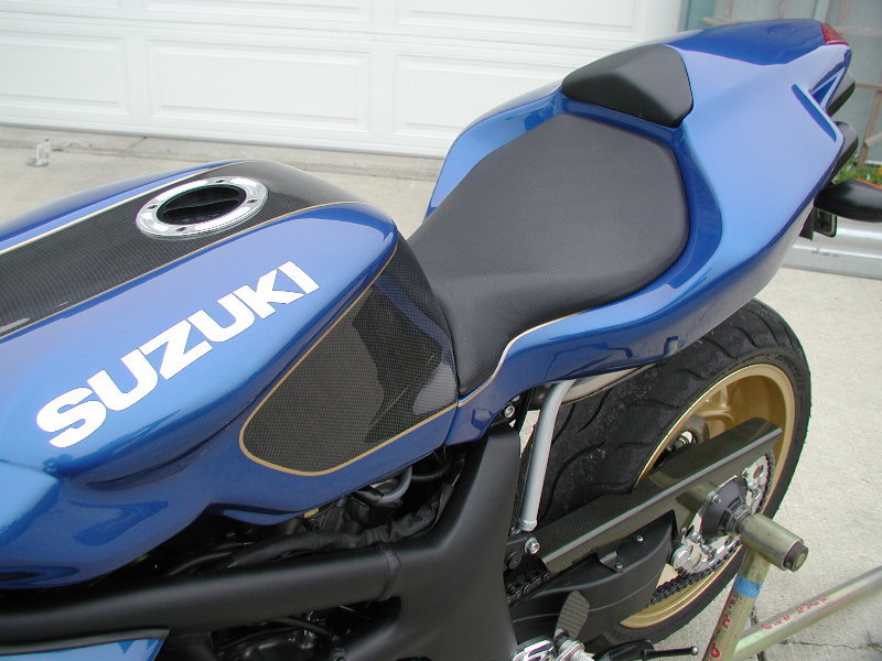

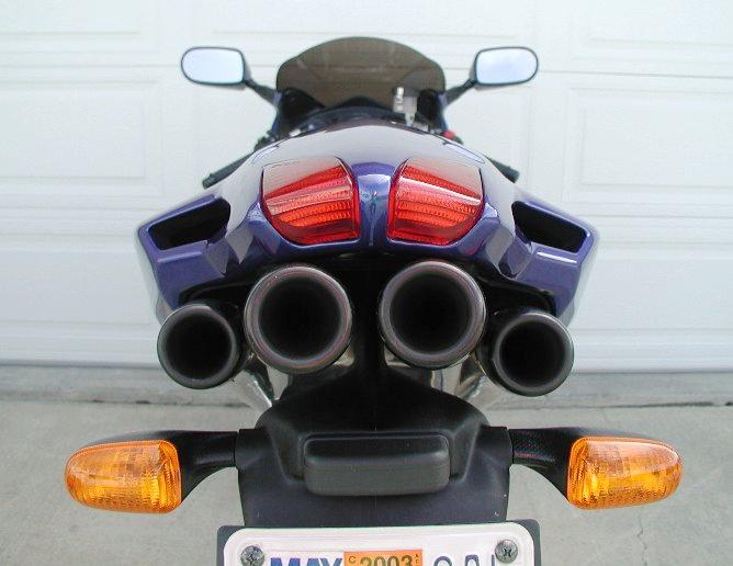

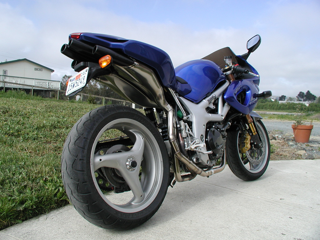

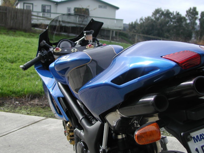

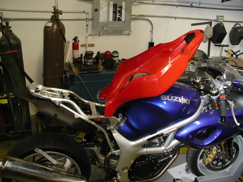

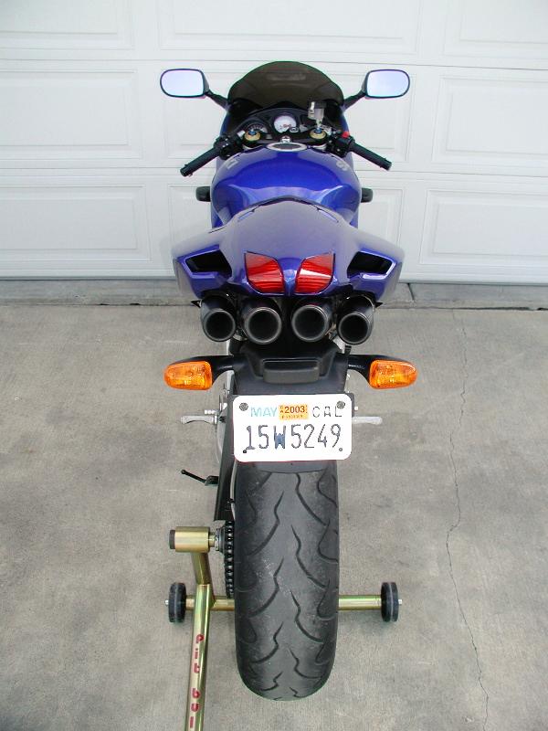

Next, we fit the tail section. I have to say, it's really interesting how well the tail fit up to the SV tank. A number of the style lines just plain 'work'. The seat height went up a bit but I like that. It puts me over the front wheel a bit more. A few folks who've sat on it say it feels a bit like a Ducati. In any case, the F4 subframe was cut to clear all the SV parts it had to clear. Once the tail was positioned, it was a matter of bending some aluminum tubing to fit and fabricating a set up that holds the tank hinge. As you can see from the pictures, the seat flips up, just like on the F4. It's all very tidy. All I had to do in terms of wiring was to slice the loom and pull out the tail light, turn signal and license plate light wiring as it needs to be able to hinge up with the tail section |

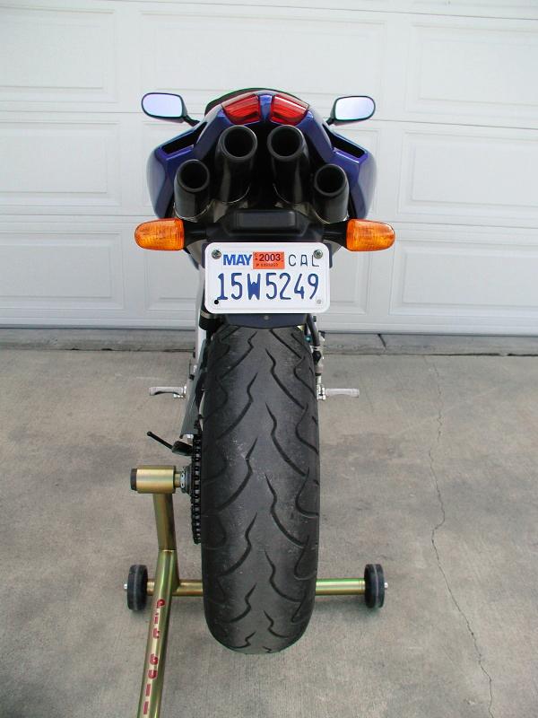

EVERYONE who approaches the bike wants to hear it. It's a little bit of a disappointment as these are stock mufflers off a 750. They are a tick louder than stock but breath better. It really is nice that it's so quiet. I wanted a bike that wouldn't upset my neighbors as I left for my weekend early morning rides. Actually, it could be a bit louder and still be OK but it does have a nice rumble and it just plain looks so cool. I could not be happier. |

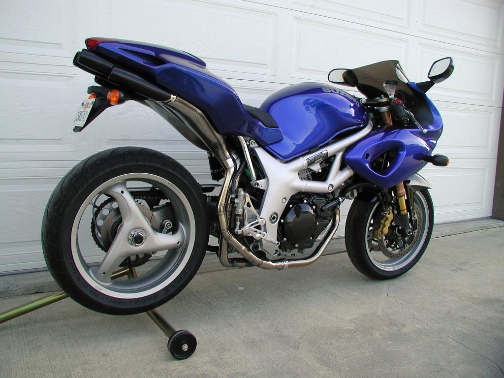

So there you have it. One pretty unique SV that, to my eye, looks like it could have come from the factory. It attracts attention everywhere it goes. I’ve met a bunch of people because most people have a bunch of questions about the bike. It’s a great conversation starter. I do have a bit more work to do and that’s most likely to be the case forever…But to me, that’s the point of a project bike, isn’t it? In closing, Project SV/MV is turning out just as I’d hoped. And yes, it is available for purchase. Serious inquires only, please. Ride Safely. Chris Baker cell: 916-799-3934 |

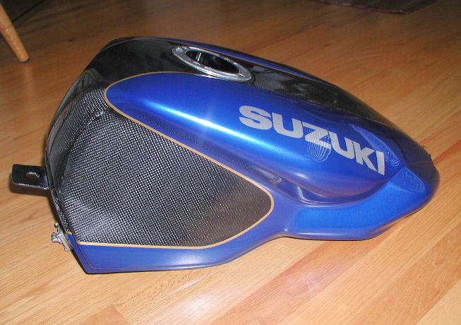

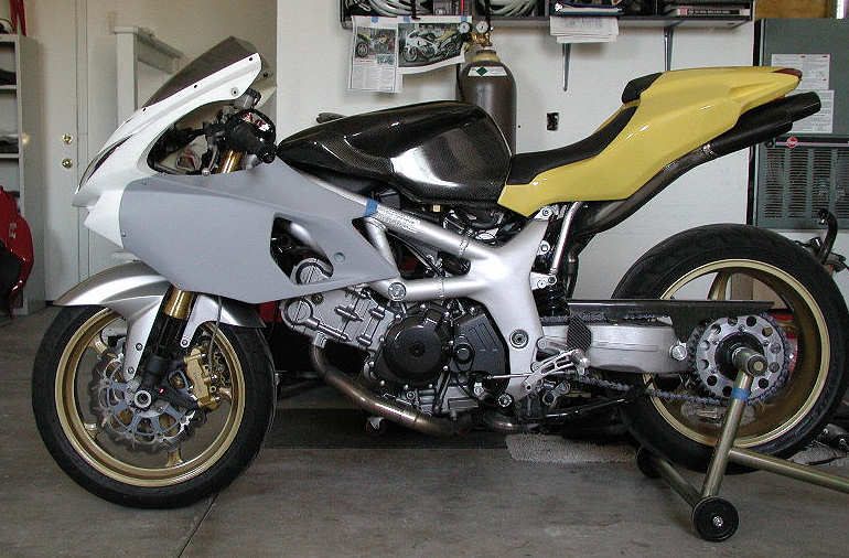

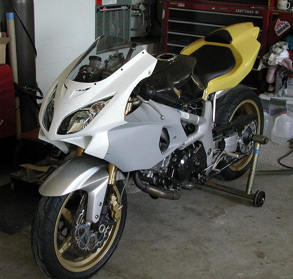

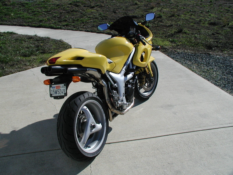

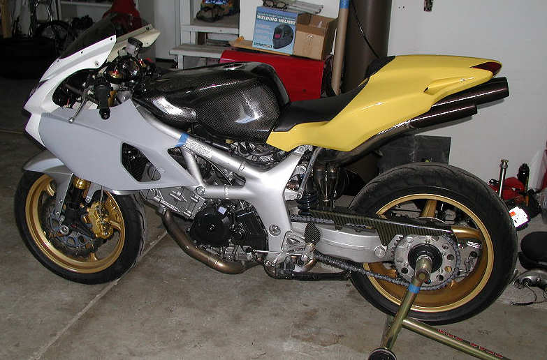

John, Thought I'd send you a few pics of the "latest phase" updates I've made to my SV. It's now yellow (I noticed ;-\) and the tank has been molded to match the MV tail. I did the work in Bondo then made a mold from the tank and made a carbon fiber part that was bonded onto the tank (after removing all the Bondo), smoothed in and, ta-da!, it looks pretty good. (I agree, the transition from tank to rear bodywork looks very impressive) The front end has Race Tech springs and Gold Valves. Tires are Dunlop D208. The shock reservoir is now mounted under the seat. (looks very neat)
Next phase is: Full carbon fiber MV replica gas tank and 1/2 fairing with MV mirrors, totally revised exhaust system, wheel updates, Wave rotors, steel front lines, a custom carbon chain guard/hugger and those custom decals. My riding buddies are all encouraging me to just buy an MV but, hey, anyone with money can have one of those...! Ride safely, Chris Baker
This is a very impressive conversion, the attention to detail is superb. As Chris says, anyone can have an MV, there's only one of these. Just not sure about that colour. See also the original article in the articles section. |

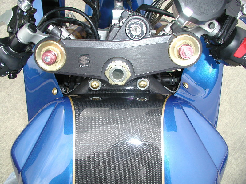

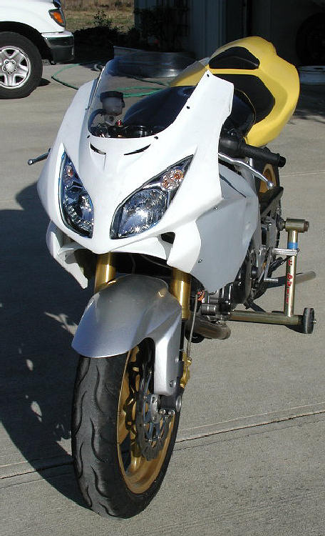

John, I hope this finds you well. Attached are some pics of early "Version II" work on my SV. I mentioned in my last message that I was going to be making an MV replica tank. Well, here's the beginning of it. Take one MV tank and airbox (now where'd that come from...?) and take a fiberglass mold of them. Use the mold to make a prototype fiberglass tank, make it fit (yikes...!) then make a mold of that. What you see in the pictures is the prototype. I'm a the "make it fit" stage. The finished product will be a carbon/kevlar tank. It's looking pretty good so far. I'll keep you updated as things progress. Ride safely, Chris Baker I love this project, where will it end? |

Hi John, Kudos for all your continued hard work on the site. We really appreciate it. Here are the latest updates on my custom gas tank project: I've finalized the shape and roughed in filler on the fiberglass. I really like the way it allows the rear cylinder to peek through. Sorta Ducati 999, maybe? (yep I thought so too) I've modified the underside to provide more space for airflow, too. The plan is to make a set of panels that fit between the frame and tank that are simply thin borders with a mesh inlay to preserve the 'see through' look while hiding some of the now-visible wiring, etc. Still working on a front fairing design but I'm also liking the naked look (SV/MV Brutale?). We'll see. More to come as it continues to evolve. Ride safely. Chris Baker |

John, Regarding your SV: Well, you beat me to the gold mesh. That's just what I have planned for my SV, too. I'll be adding the mesh to the fairing, the MV tail vents and the panels under the new tank. Your SV really looks the dog's. Have I got that right? ;-) (yep) Nice job. So, here is latest on my new tank. This is the final buck ready to be used to make the production mold. Being that I'm new to all this I've got maybe 40 hours in this part. I think I'll be keeping my day job... My goal is to pull the mold for the underside this weekend and get the carbon/kevlar underside part made. If all goes well I may get the splitter plate and half the upper mold made as well. I'll try and remember to take some pics of the process. It's pretty interesting and much easier than people think. More updates as things progress. Ride safely. Chris Baker Chris, you're having a laugh. How can you compare my pathetic attempts to customise my SV against wonderful machine. Here are the latest photo's of Chris's MV-SV.

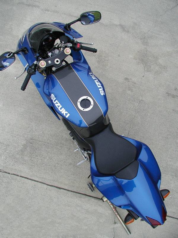

Hi John, Well, I finally got around to laying up my carbon/Kevlar tank. It's 2 layers of carbon, a layer of Kevlar, then a layer of fiberglass and a final layer of carbon. The Kevlar is only running along the sides as that's the area most likely to take a hit in the case of an accident. Carbon is light, but drag it along the road and it grinds right away. Not the hot set up when there's fuel on the other side. A layer of Kevlar provides a nice safety net. Overall, it turned out pretty well for a first effort. Not perfect but it's getting mostly painted. And let me tell you, it was a royal pain to make. LOTS of complex shapes to cover. Still need to do final trimming then fit the gas cap and fuel outlets. Then the bottom gets bonded on and I'm away! I think I'll sacrifice an SV tank, cut the whole gas cap mounting area out and bond that in from the underside. Then I can run the standard locking cap. Not the lightest approach but very sano, matching key and keeping with the 'from the factory' look I'm hoping for. With a bit of luck, I'll have it done this coming weekend, assuming I can find a donor tank. Then it's off to the painter again. You'll be happy to learn it's going back to blue. I'm thinking about the blue on the Subaru WRX.. We'll see. Thanks as always for the great work on the site. Ride safely, Chris Baker Looks absolutely delicious to me, it's a pity to paint it |
